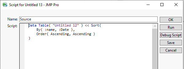

  1. If you run the sort interactively
    1. Tables=>Sort
    2. Then in the resulting new data table, you right click on the "Source" entry in the Tables Panel on the upper left portion of the new data table and select "Edit"
  2. Here is a cleaned up version
    Names Default To Here( 1 );
    dt = Current data table();
    dt << Sort( By( :name, :Date ), Order( Ascending, Ascending ) );
  3. Also, given the example I had provided in my last entry, a guess could have been made on how to expand on it to sort 2 columns.
I strongly recommend that you take the time to read the Scripting Guide in the JMP Documentation Library.

txnelson
Re: How to use JMP script to sort Data Table by two columns
    1. Tables=>Sort
Jim
