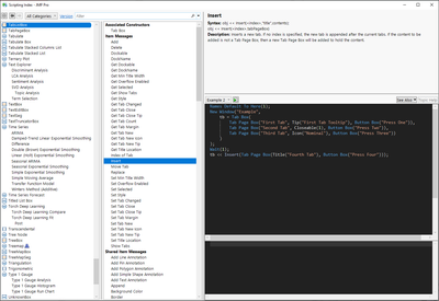

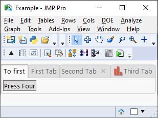

Re: adding a table on the firts tab of a dashboard
You can use Insert with Tab Box to determine into which position display box should be added
With index
Names Default To Here(1);
New Window("Example",
	tb = Tab Box(
		Tab Page Box("First Tab", Tip("First Tab Tooltip"), Button Box("Press One")),
		Tab Page Box("Second Tab", Closeable(1), Button Box("Press Two")),
		Tab Page Box("Third Tab", Icon("Nominal"), Button Box("Press Three"))
Wait(1);
tb << Insert(1, Tab Page Box(Title("To first"), Button Box("Press Four")));
-Jarmo
