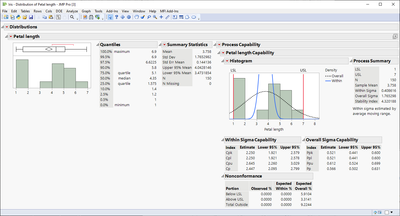

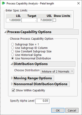

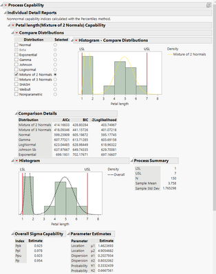

I would guess if you told JMP to use non-normal distribution it will tell what method was used. Otherwise it will assume normal distribution.
Using normal distribution (or no changes to distribution)
Told JMP to use nonnormal distribution
Normal is still visible on the left
From Process Screening -> Launch Process Capability -> Compare Distributions -> Selected as Mixture of 2 Normals (visible on top)
-Jarmo

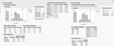

jthi
Re: How to find out which formula was used if there are different formulas available based on different conditions?
Where do you have your Cpk/Ppk values? For example in Process Capability (from distribution platform) it seems to be visible here

RMSEBird223
Level II
Thanks for your reply. I use Cpk/Ppk calculation via the distribution platform (like you showed above) and via the process screening platform. What you showed in your example above is exactly what I was looking for. Unfortunately, I don't have this information if I run it on my side. I guess I have to change my preferences for the distribution platform

jthi
-Jarmo
