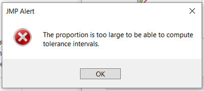

@Byron_JMP : The tolerance interval is a curious criteria to apply. An interval with alpha 0.95 and proportion 0.99... is saying I'm 95% sure 1% of the tablet weights will be outside this range.
You cannot set proportion to 1.0 (100%). The nearest is 0.999
