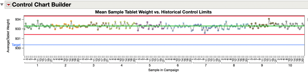

The second control chart might compare the average sample weight to a historical, fixed, control limit from a time when the process was stable and in control. This is not a three standard deviation control limit, but a 3 sigma limit base on the moving range, normal control chart limits.
That chart might look like this.
Screen Shot 2020-07-09 at 5.17.26 PM.pngScreen Shot 2020-07-09 at 5.17.26 PM.png
