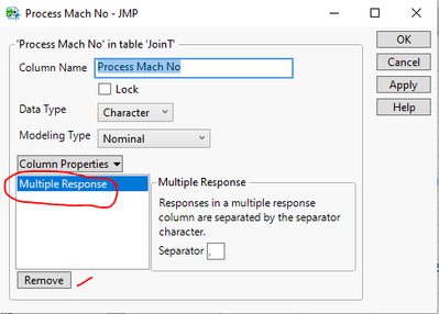

3 ACCEPTED SOLUTIONS
Re: Why my saved Interactive Html (Graph Builder) & Local Filter not interactive?
Hi @WebDesignesCrow ,
Thank you for sharing your log output.
In the lines starting with "Interactive HTML:" I can see that there are two Columns with modeling types that are not supported by Interactive HTML. "Process Mach No" and "Process Oper".
The following lines create these columns by combining other columns:
//combine Mach No with Oven No into "Process Mach No"
dt2 << Combine Columns (
	delimiter(","),
	Columns(
	 :Mach No,
	 :Oven No
	Column Name("Process Mach No")
//combine Oper Desc & Cur Oper into "Process Oper"
	delimiter(","),
	Columns(
	 :Oper Desc,
	 :Cur Oper
	Column Name("Process Oper")
The result of Combine Columns is a multiple response column which is the modeling type that is not supported by Interactive HTML.
You can convert the multiple response columns into columns with Data Type = Character and Modeling Type = Nominal, using the Concat transform. I see you have already used this in creating the Local Data Filter:
Transform Column(
					"Concatenate[Process Oper]",
					Character,
					Formula( Concat( :Process Oper ) )
 Or, rather than using Combine Columns to make a multiple response columns, you could Concatenate the columns using a comma separator. It would be something like the following:
Transform Column(
				"Process Oper",
				Character,
				Formula( Char( dt2:Oper Desc ) || ", " || dt2:Cur Oper )
In the Formula, you may not need to use the Char() function if the Oper Desc column is already a Character data type and you might need to add it for Cur Oper if the Cur Oper column is not a Character data type.
These are just suggestions. You may be able to find a better way to avoid using the multiple response modeling type for reports you want to export to interactive HTML.
I hope this helps.
~John

For now, I just revisit the whole script and change the earlier scripting during combination of those two columns.
dt2 << new column ("Process Mach No", character, Formula(:Mach No || :Oven No));
dt2 << new column ("Process Oper", character, "Nominal", Formula( Char( :Cur Oper ) || "_" || :Oper Desc ));

WebDesignesCrow
Hi John,
Thanks for the reply.
Somehow, I still fail to remove the "multiple response modeling type".
I thought the fastest way to remove the "multiple response" is by assigning by using below script;
dt3 = Data Table( "JoinT" );
dt3:Process Mach No << data type(character) <<modeling type(nominal) <<column properties(remove Multiple Response);
dt3:Process Oper << data type(character) <<modeling type(nominal)<<column properties(remove Multiple Response);
I prefer to change the columns' properties after I've combined the tables & columns.
I can remove it manually, but I would like to use script to automate the task of removing the multiple response for both "Process Mach No" & "Process Oper".
Any idea how could I use script to remove the multiple response?
Thanks !

WebDesignesCrow
Thanks @Craige_Hales !,
I will try above method as well (as alternative).
