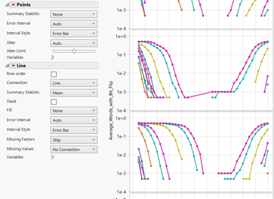

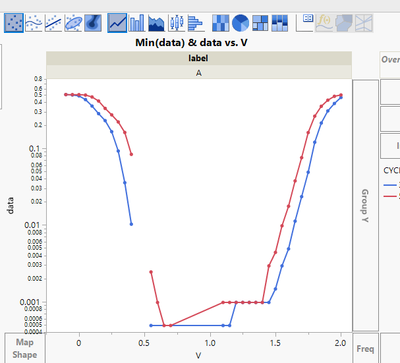

I have a points and line chart below. the pink line in the middle graph is not supposed to connect as the selection is no connection for missing value, other color lines in the middle chart did not connect and bottom chart the pink line is not connected. I have hard time to figure out why.

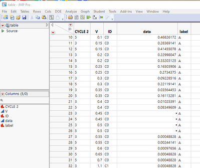

Georg, pls. see attached table. Column V is continuous with step size 0.05.

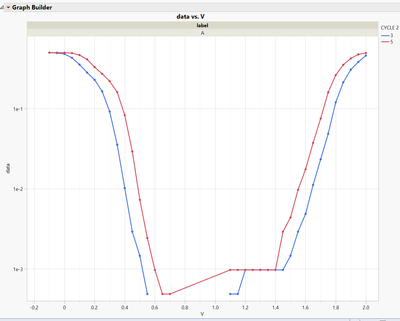

The sample data table you provided did not have any missing values.   Theefore, I modified the table to have a couple of missing values for each level of Cycle2
And the resulting graph honors the No Connection option

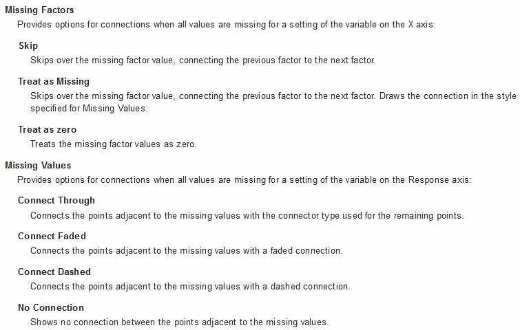

You might want to play around with the different settings Graph Builder provides for missing factors
Skip:
Treat as missing:
Essential Graphing > Graph Builder > Element Types and Options > Line  (whole Essential Graphing is good read for all JMP users)
