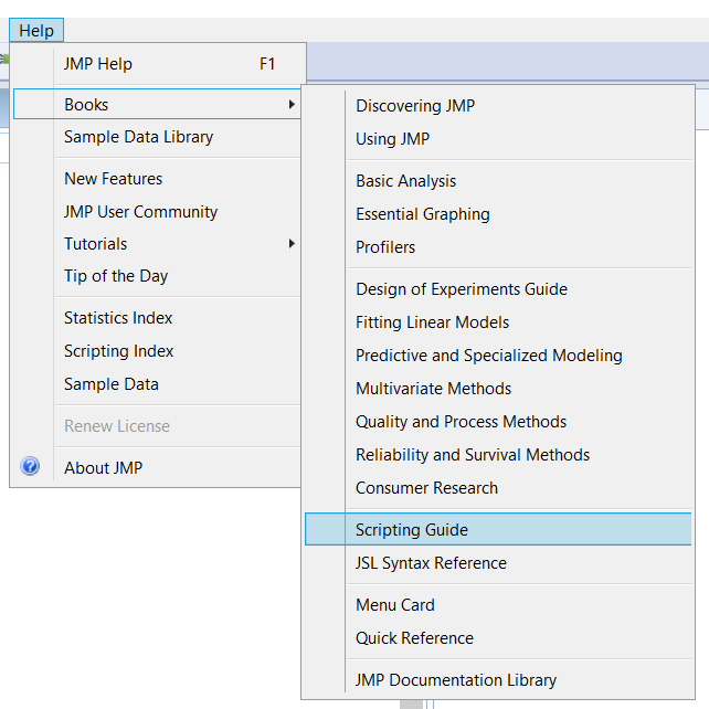

       I guess you were looking under the incorrect section when looking in the case of a column formula. Here
It will be helpful for you to get used to tapping into the resources that come with JMP. If you were to look into the Scripting Index, you would find :
Additionally, resources like the Scripting Guide provide extensive detail on each topic.

Just a few comments to add to @uday_guntupalli response:
  • From Help > Books > Using JMP,  Chapter 7, Formula Editor, shows the ins and outs of using the formula editor, especially some keyboard shortcuts to construct Match and other conditional formulas.  The last secion of this chapter provides example and tutorials.
  • Appendix A of this book, Formula Functions Reference is a 60+ page reference of the different functions.
  • As @uday_guntupalli pointed out, using the JMP Help > Scripting Index > Functions is the easiest method to learn about functions.  Most examples contain a a Help button that links you to additional details. Some show multiple examples. See Functions > File > Open,  look for an upside down carat, ^,  (a menu pull down) to the right of Example 1. Functions manipulate  or find information about JMP objects, numbers (including Boolean 0,1), strings, lists, matrices, columns, displays and system files and produce (return) objects numbers, strings, lists, matrices, columns, displays and system files.
