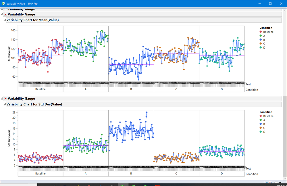

I have no idea how your data were collected so the attached example data table with embedded graphs are meant to show you visual and analytical possibilities using JMP. The JMP table contains simulated data for 100 tests, each run with A, B, C, D and Baseline conditions and the "distribution" is 20 measurements that represent random effects ( versus fixed effects: such as, measurements taken on fixed locations of an object; or taken at a specific sequence of time intervals, such as a drug efficacy test where measurements are collected at 0, 1hr, 5 hrs, etc.).  The simulation's test-test variation is large; a shift was added after after run 75 to make the effect even more visible.
The attached table  contains 3 embedded scripts:
  1. Variability Chart of Value - A plot of the raw data grouping by Test, Condition. On the right hand side of the X-Axis click on Test and drag it to Condition.
  2. Summary Plots - Creates the table Test Summary that computes the "distribution" mean and stdev of each Test/Condition, then plots variability charts comparing "distribution" means and std dev grouping by Test, Condition then Condition, Test;  four plots in all( see the two Condition,Test plots below).
  3. Dunnett Comparison with Test as a Block Factor - This script uses the Test Summary table and a Oneway ANOVA, using Test as a Block.  This removes the test-test factor and performs a Oneway comparison of the block differences.
Note I built the simulation so that Baseline and D have the same means (C is not too far off), and Baseline and C have the same std dev.
Please keep in mind, if your experiments were not run like this likely #3 is not the best analyses, however, graphs like #1 and #2 should provide you with some insight to your experimental results.
Mean & Std Dev grouped by Condition, TestMean & Std Dev grouped by Condition, Test
