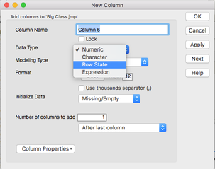

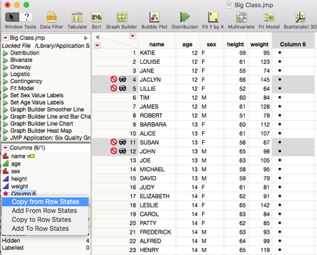

A Row State Column is used to store row states and will be preserved across table operation.
Create a new column and give it a Row State Data Type.
Then you can click on the star in the columns panel of the data table and choose "Copy from Row States" to capture the current row states.

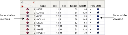

While it's true that the Row State Column was preserved after a I did a Table Join,  the _actual_ Row States were cleared.
How can I make the _actual_  RowState of the new, joined table automatically update to reflect the information contained in the Row State Column?

The attached imiage file in my previous post is a screenshot of my joined data table, showing how the actual Row State didnt update after the table join.
I fumbled, but couldnt get the screenshot to display inline with the text of my post.

You apparently followed Jeff's example from above and generated a column with the Modeling Type of "Row State" and then right clicked on the red star for the new column and selected "Save from Row States".  Once you complete the join of your tables, you can then go to the column that you saved the row states to, and this time after to right click on the red star, select "Copy to Row States".
