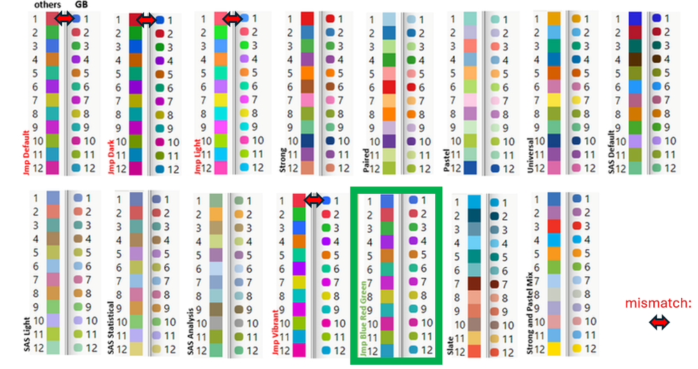

hogi
Level XIII
Re: What is graph builder's color ordering different than other charts?
To fix the issue, use JMP Blue Red Green
- no change for Graph Builder
- plus: same color scheme for the other platforms
https://community.jmp.com/t5/JMPer-Cable/Graph-Builder-color-theme-add-in/bc-p/626423/highlight/true...
hogi
Level XIII
@katharina_l , switching to JMP Blue Red Green solves a lot of issues.
Default-GraphBuilder-users won't even notice the difference - and when they use another report once in a while, they will find the same color scheme there ; )
