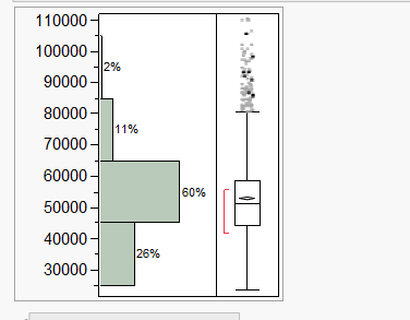

Thank you for your response. I tried this method and it seems JMP will divide the group based on the value of the variable, which will leave the group evenly distributed ( bars are not the same length/height). Say for example, if I have 1000 rows of income data, I want to save the top 250 income records as group1. In JMP, even if I make it to 5 group, as the example I show below, the first group will not have 250 observations.

Try this Interactive Binning Add-in: Interactive Binning (V2)
