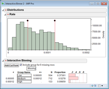

Interactive Binning lets you create discrete groups from continuous data. The histogram shows the distribution of values for your variable. Cutpoints are shown by the vertical red lines and in the table below the histogram.
Click and drag the handle near top the cutpoint line to move the cutpoint. Drag a cutpoint out of the graph to the left or right to delete it.
The first group is all the data less than or equal to the first cutpoint. The last group is all data higher than the last cutpoint. The righthand side of the interval is always less than or equal.
Name the groups using the Groups Names fields. Leave them blank to name the groups with the range values.
If you delete the only cutpoint, it will reset to the center of the range of the data.

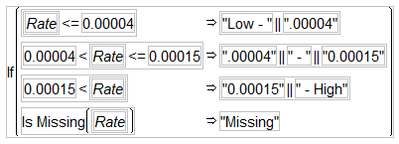

Save Group Column
Use this command to create a new column in the data table with a formula to bin your data into groups.
Leave the group names blank you get names based on the range of the interval.
