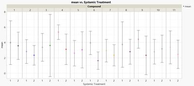

i occasionally get datasets, where there is no raw data available, just the mean, st.dev. and number of replicates. Is there a way to use this available data to run a t-test, for instance? A quick platform launch is included to show what I want to do.
I was thinking, that maybe constructing a simulated distribution (let's assume it's normal) with the given parameters and counts could be the way to go, but I I'm not sure how to do that. Does anyone have an idea? A scripted solution would be good, i could adapt that.

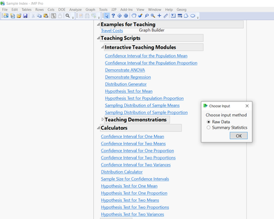

You can use --> Sample Index --> Teaching Scripts for a t-test with summary statistics:
But may be not appropriate for many rows.

Hi Georg, thanks for this! Didn't know this option existed! Doesn't scale too greatly unfortunately.

I would probably use this graph to understand the data, mean on y and stddev as interval:
Resampling can be done of course, but will not lead to a good assessment with small differences.
