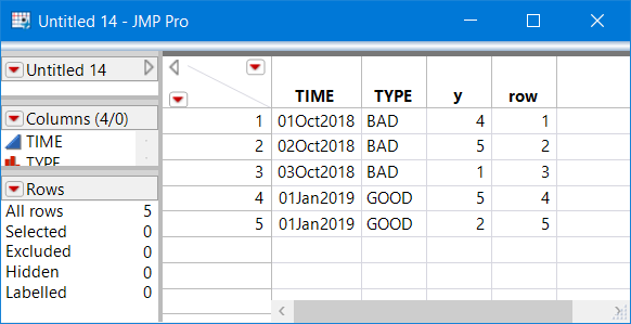

I do not know how to make GraphBuilder do what I think you want unless you restructure your data table. GraphBuilder will not nest different data types, and X-Grouping uses the same X scale.  So the only way to do this is to make each group's (Type) time (X variable) its own column and drag them side by side.  Below is a capture of your table layout and a restructured, Split table: Split  :Time by :Type grouping by :row and keeping all columns.
 Your specified table layout - Row # column addedYour specified table layout - Row # column addedDate Split by Type, Grouped by row #Date Split by Type, Grouped by row #
