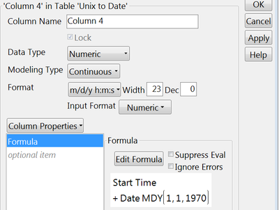

Re: Unix Timestamp to Real Date & time
Just an add to Jeff's post.  When I used his formula I got back the number of seconds.  I added the MDYHMS format to the formula to get date and time
Bill
Another add - talked with Jeff offline and he made a very good point.  Don't use the character string "MDYHMS" if you want to do some math with your time stamps.   Use Column Info to format your new times as continuous data.

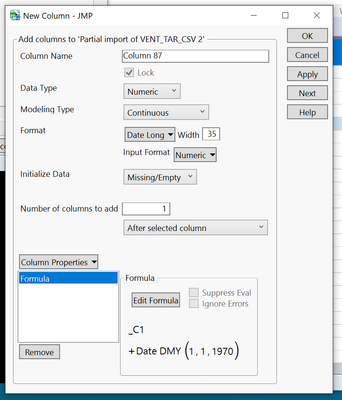

dpeyer
Level II
Hi Bill,
I know this post is from forever ago, but I am trying to do the same thing and failing. I have the formula and all that input into the new column, but I cannot find the option to select m/d/y h:m:s for the date convention. I am only given the options to select the many variants of m/d/y. Is there something that I am missing to get the time included in the date output? Thanks.
txnelson
You have clicked on "Date" for the selection of the format to choose from. Select "Time" and it will give you all of the Date/Time formats
Jim
dpeyer
Level II
Yup....knew I was missing something lol. Thanks!
