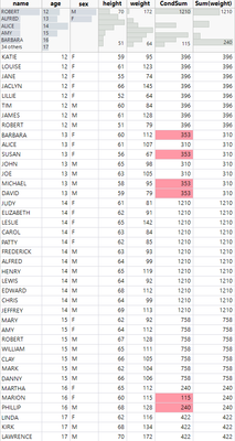

There is another variant where the condition is used to restrict the aggregation to one subset - and the result is written to all rows of the respective group. Like in te last column of this table:
One option to get there:
Use Tables/Summary with a Data Filter (new in Jmp 17) and merge the values back to the main table:

Names Default to Here(1);
dt << New Column("CondSum",Numeric,Continuous,Formula(Col Sum( :weight, :age, :height > 60 )));
dtSum= dt << Summary(
	Local Data Filter(
		Conditional,
		Add Filter( columns( :height ), Where( :height > 60 ) )
	Group( :age ),
	Sum( :weight )
dt << Update(
	With( dtSum ),
	Match Columns( :age = :age ),
	Add Columns from Update Table( :"Sum(weight)"n ),
	Replace Columns in Main Table( None )
Other approaches (with a variety of speeds) are discussed in  How do I use the Col Maximum Formula with a "where" condition.
