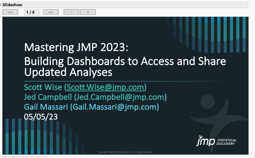

bonjour,
je voudrais un modèle de slideshow (comme l'image ci-dessous) pas dans un journal mais un dashboard construit avec jsl.
est-ce possible?  comment faire?

The very excellent Journal Text Sledgehammer Add-in, made by @brady_brady can do this for you. Also, here's a link to a video of @ruthhummel explaining how to use all the features.

Bonjour,
merci pour votre réponse.
je ne veux pas créer un slideshow dans un journal mais un dashboard, donc par un script.
cordialement
Re: slideshow
You could likely copy/adapt the script that the Sledgehammer Add-in is using. A quick way to get to the Add-in folder is to use View...Add-ins, then click the link to go to the Add-in folder. In it, there's a SlidesIntoJournal.jsl script that could serve as a base for your needs.
