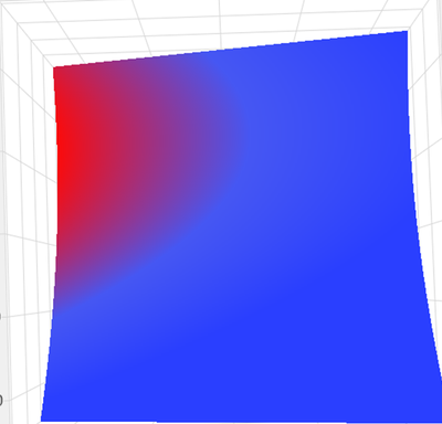

The only thing I can achieve in JMP (version 18.1) is this

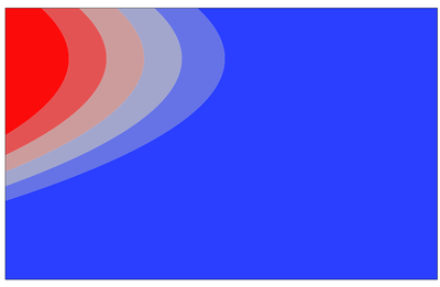

and also this from the contour plot
Both visualizations are not exactly what would be nice for presentations. Projecting a 3D plot on 2D is not exactly plane and I cannot get a smooth colouring in the contour plot. It will always require levels for the colouring.

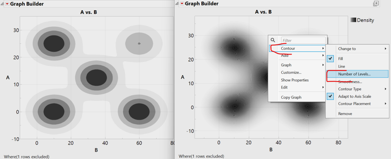

In the bottom plot, you could right click into the graph, then select Contour > Number of Levels ... and set this to a high value. Below an example where the nr of levels is changed from 4 to 100.
