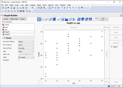

You might want to stack your data to possibly make this a bit easier. As you didn't provide the data, I will use JMP's Big Class for example (I'm also using JMP18 it can affect some features such as labeling)

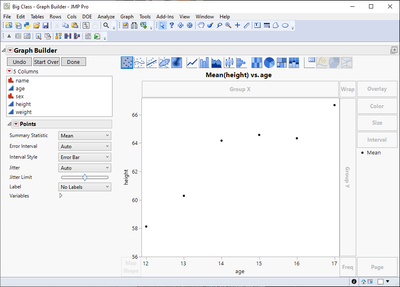

Then I can change Summary statistic to mean

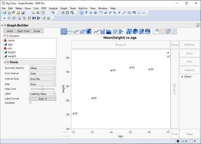

set label by value

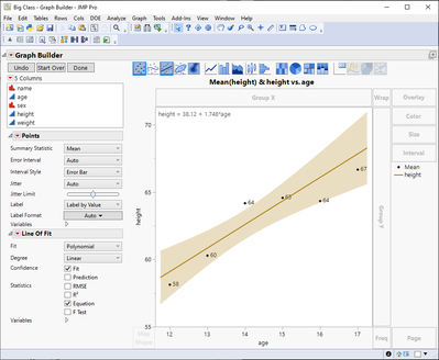

Fit a line and enable Equation
