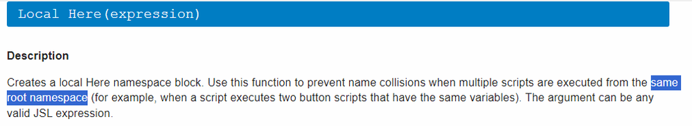

If that the case, could you advise what is the best approach for "root namespace"? I'm using Global namespace right now and intent to leverage to Here namespace and avoid namespace pollute. My script is involved ~80 variables.

Depends on what you are doing. You can utilize named namespaces, anonymous namespaces, global, here, local,... but still, I would almost always start my scripts with Names Default To Here(1);
