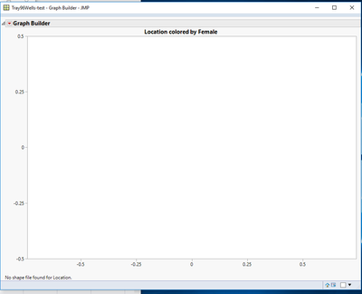

Yes, I tried dragging my response variable to the middle, still is showing an empty graph with error message "No shape file found for Location".

I don't know what is wrong.
I verified that my 96-well example is working. Then I examined your files and found them to be correctly defined but I had the same problem as you. I created a new data table for the Name and XY information, copied your data values to my tables, added the column properties. I tested it with all the files together in the same test folder but nothing help. The problem is not the data, it is one of your shape files.
I recommend that you contact JMP Technical Support for further help. ( [email protected] )

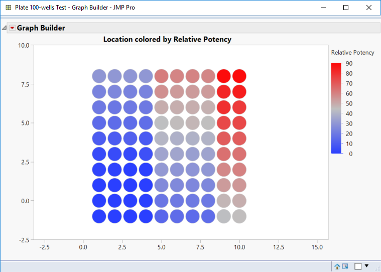

In the meantime, I created the shape and test files for 100 wells. I did not take the time to remove the 4 center wells from the shape files or the test file. It works for me.
Be sure to save the files together or move the two shape definition files to the common shape folder documented for your version of JMP.
There is definitely something wrong with the shape files that you created, but I can't see what it is.
