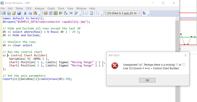

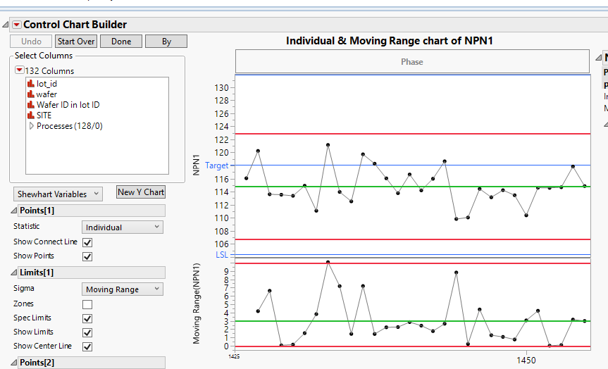

The first option that I suggested does not require subsetting!  See the script belowchartbuilder.PNG
names default to here(1);
dt=open("$SAMPLE_DATA/semiconductor capability.jmp");
// Hide and Exclude all rows except the last 30
dt << select where(Row() < N Rows( dt ) - 29 );
dt << Hide and Exclude;
// Unselect the rows
dt << clear select
// Run the control chart
cc = Control Chart Builder(
	Variables( Y( :NPN1 ) ),
	Chart( Position( 1 ), Limits( Sigma( "Moving Range" ) ) ),
	Chart( Position( 2 ), Limits( Sigma( "Moving Range" ) ) )
// Set the axis parameters
report(cc)[AxisBox(1)]<<min(nrows(dt)-30);
Jim

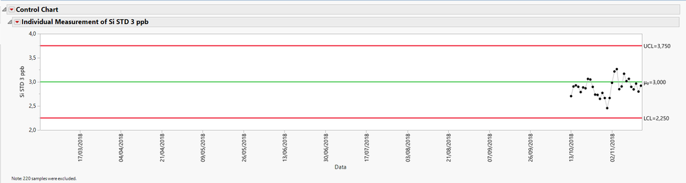

js1985
Level II
Re: Tips to improve control chart visualization
Hello,
the script is working fine to select last 30 datapoints but I think I'm getting a problem in setting the min and max on the X axis as per below screenshot:
txnelson
The line
apparently is not finding the AxisBox() that it needs to change.
  1. Did the example that I included in my Dec 13th 3:23(my time) work correctly?
  2. Is the variable "dt" being assigned to point to your target data table?
  3. Is the "cc" pointing to the Control Chart Platform
cc = Control Chart(
It would help to beable to see the actual code that you are using.  Could you please provide that code?
Jim

Regarding the first bullet point, we I rant that code I'm getting this
For points 2 and 3, how can I check this?
txnelson
Oops....a couple of mistakes.
There needs to be a ";" after the dt << Select Clear;
The Chart you are using needs to have AxisBox(2) referenced, not AxisBox(1);
