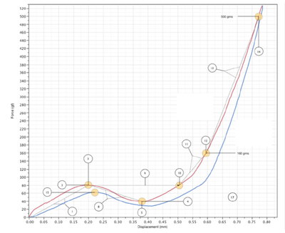

We are trying to evaluate the differences between measured data against an ideal baseline; in this case we're comparing the shape / magnitdue / quality of force displacement curves.
We've in the past compared the various slopes, peaks and valleys to do this, but are finding this doesnt capture all the variation we are seeing.
Is there a way to compare the entire "shape" of one curve against that of a baseline (for example comparing red vs blue in my attached plot)?

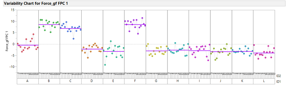

I did this in just a few minutes with Functional Data Explorer, FDE (requires JMP Pro 14) and without knowing your data, so it's not in any sense definitive. But it does confirm Jeff's suspicion that this might be an approach worth investigating.
It looked like ID1, ID2 and ID3, taken together, identify a unique trace. Using FDE showed that the first functional principal component accounted for nearly 95% of the variability between the traces, so might be a good measure of similarity or distance:
Take a look at the scripts within the updated table.

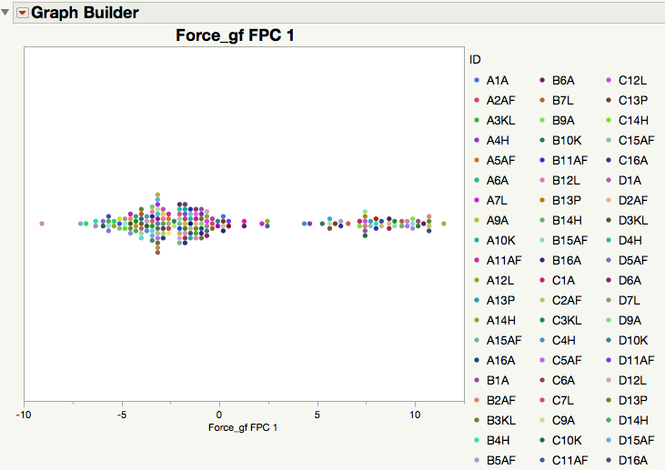

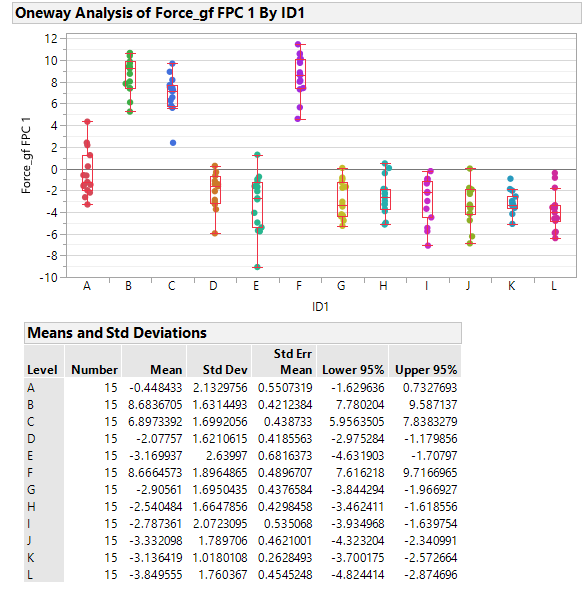

This is just a different view of the @ian_jmp's results: a variability plot, and a bivariate of Force_gf FPC1
