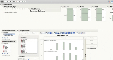

Hello,
I meet some problem can't solve by myself. The part of my code is as below.
Graph Builder(
	Variables( X( :DQ_Read_Right ), Group Y( :PCB ) ),
	Elements( Histogram( X, Legend( 4 ), Means and Std Devs( 1 ) ) ),
	Column Switcher( :DQ_Read_Right, {:DQ_Read_Left, :DQ_Read_Right} ),
	Column Switcher( :PCB, {:Vendor, :CPU, :DRAM, :Temp, :V_level, :PCB} ),
	SendToReport(
		Dispatch({},"DQ_Read_Right",ScaleBox,{Inc( 2 ),Minor Ticks( 1 )}),
		Dispatch({},"DQ_Read_Left",ScaleBox,{Inc( 2 ),Minor Ticks( 1 )})
The left side data is ok, but the right side data has gaps between the bar. The detail as following gif link. Does anyone know what is the problem?
Even I set the Inc(2) can eliminate the gap. When I operate Graph Builder, the increment will change back to 1.

HI @JustinLin,
  I think it's because Graph Builder is designed to automatically update the graphs if you resize the window or switch out columns, etc. I think Graph Builder also tries to optimize the display options, which leads to the gaps showing up in your bar graphs. Since it's dynamic, I'm not sure it's possible to get around it.
