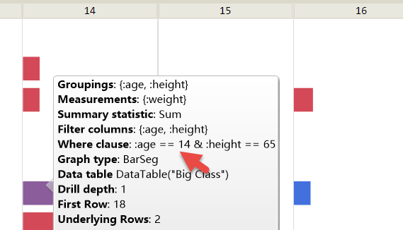

lala
Level IX
回复: How does JSL implement a click-to-get variable value in such a graph?
If click on the space indicated by this arrow, can get the age value =14?
It's a left mouse click, not Hover Labels.

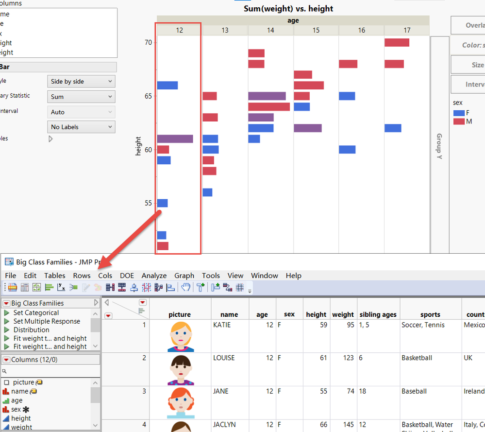

lala
Level IX
  • How to execute this JSL with a mouse click?
lala
Level IX
If it is triggered with Hover Labels, why can it only be triggered to open Big Class Families.jmp at age ==12?
  • How can I make other age columns trigger as well?
Thanks!

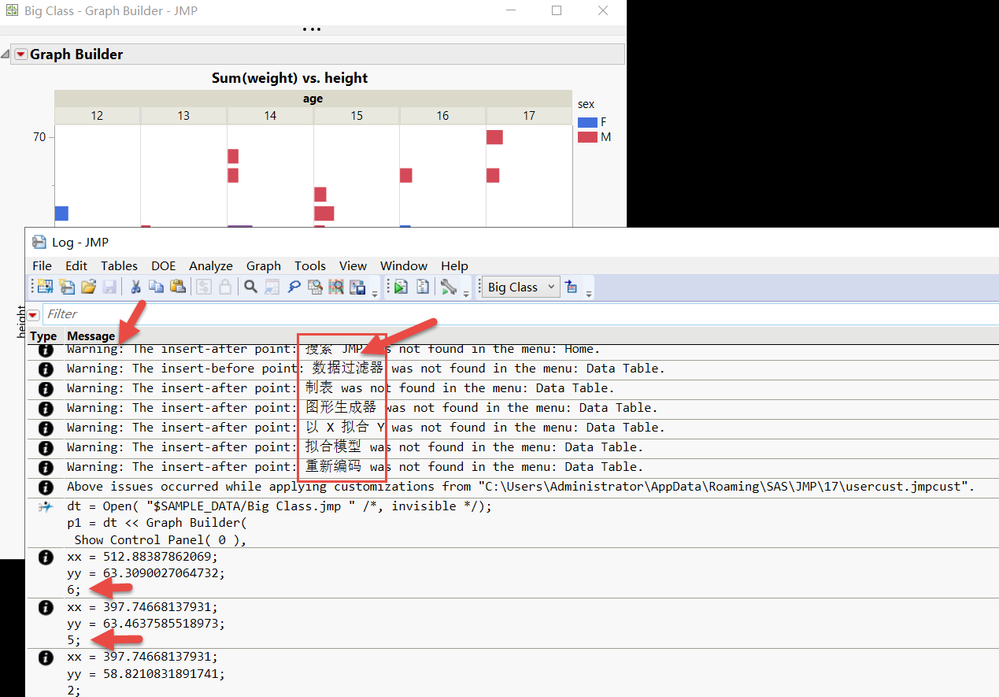

lala
Level IX
Thanks Experts!
Very amazing, have seen xx, yy and Expr(iFrame) changes.
lala
Level IX
But why doesn't this script work in the Chinese version of JMP Pro 17.0?
win10
Thanks!
lala
Level IX
Set my version 17 of JMP to English.
It works, but there will be Chinese in the log?
Thanks!
