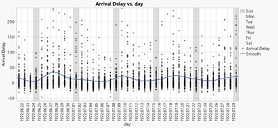

Hello, I am working on a graph looking at cyclical trends and was wondering, is there any way to apply shading to specific days/times in graph builder to draw attention to the specific ranges? I have attached an example image of what I'm trying to do below, where I added shading to the weekends in a photo editing platform.

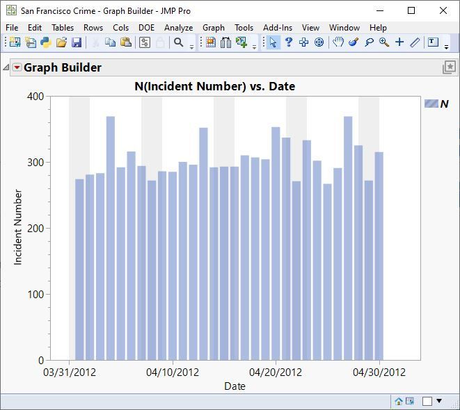

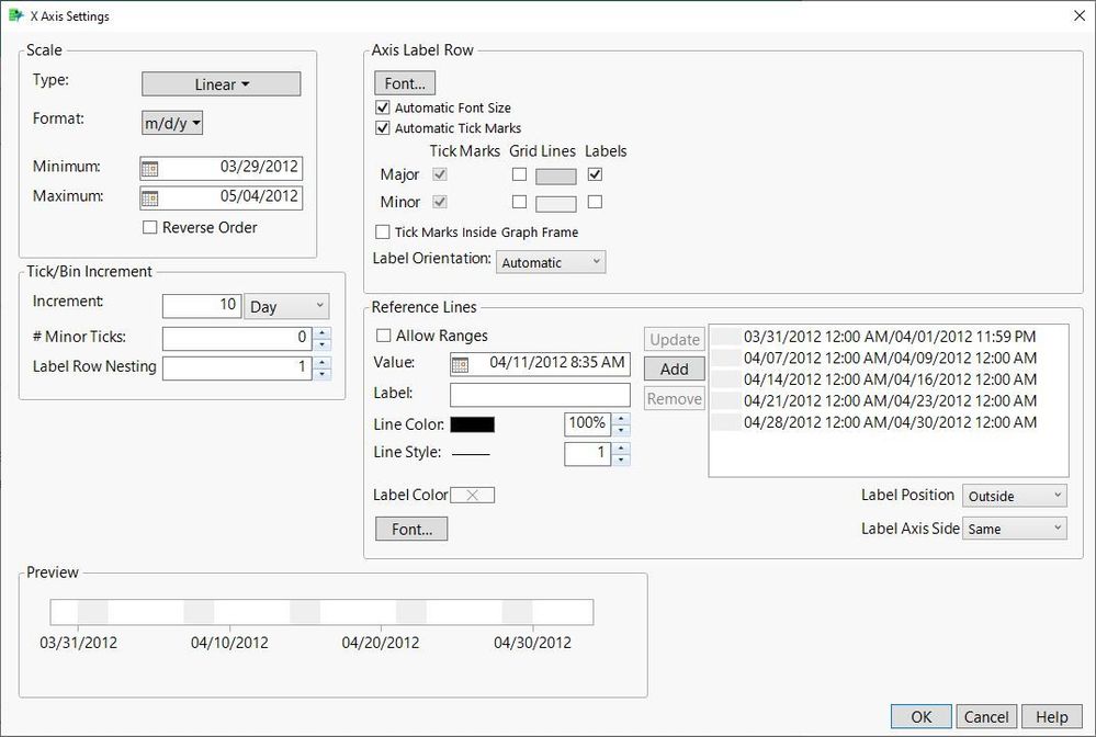

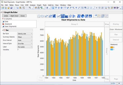

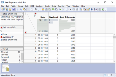

One thing to note about my solution is that it isn't really adding "shading". It will recolor your bars and sometimes that might not be what you want. For shading type of tasks the other options here are better
