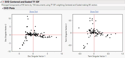

Hey, @markschahl!
Topic analysis is one way, I'm also a fan of the SVD plots themselves (example in the image below also JMP Docs 1 and JMP Docs 2).  The tendrils going away from the center of the plot tend to have similar themes.  The doc SVD and term SVD plots provide slightly different views of the data.  You'll want to have a look at both.  With any luck, your document of interest will sit far out on a tendril which should give you some good candidates.
Since you have meta data and tokens, you might also give the Torch add-in a try.  It has some language models that might do the trick.

Hey, @markschahl!

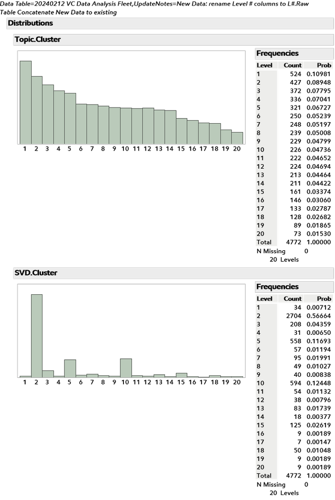

Re: Text Explorer: find similar documents starting from a given document
Mike:
What's interesting is comparing the Topic Analysis to SVD. SVD shows that ~56% are talking about the same thing(s).
I'm rethinking about how many topics/clusters I should ask for. Any guidance? Is there a scree-plot equivalent for this?
