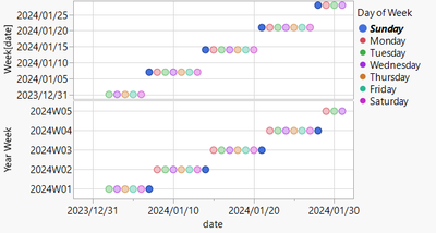

year-week can be calculated in different ways.

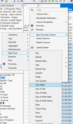

a)  via the right click context menu/new formula column :

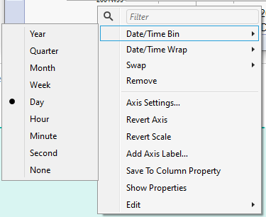

b) via Time Bins in Graph Builder [via DateIncrement(date, 0)]
This plots shows both values in the same graph.
On the top is: week by binning in Graph Builder, the bottom graph shows the week calculated via new formula column:
Why is "week" not defined consistently at both places ?!?
How can I make the weekly binning in Graph Builder start on a Monday ?!?

Actually, I am fine with what  new formula column generates - with Monday as first day of the week :)
My issue is the Date/Time Binning in Graph Builder.
Date Increment( :date, "Week", 0 )
is a cool trick - but the developer of this functions seems to work in another country than me.
