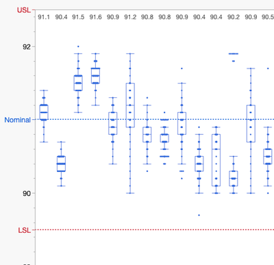

I'm using Mac version, and want to save some boxplot charts to PNG by jsl.
How to improve the PNG picture resolution?
I used below jsl and change resolution number, it sames not take effective.
graph1 <<Save Picture("/Users/Downloads/TEST"||"/TEST-"||text||".png","png",resolution(600));
The resolution is not good as below.

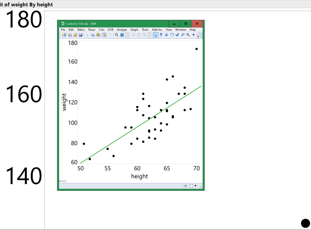

Or, try something like this:
dt = Open( "$sample_data/big class.jmp" );
bv = Bivariate(
	Y( :weight ),
	X( :height ),
	Fit Line( {Line Color( {61, 174, 70} ), Line Width( 10 )} ),
	SendToReport(
		Dispatch( {}, "height", ScaleBox, {Label Row( Set Font Size( 72 ) )} ),
		Dispatch( {}, "weight", ScaleBox, {Label Row( Set Font Size( 72 ) )} ),
		Dispatch( {}, "weight", TextEditBox, {Set Font Size( 72 )} ),
		Dispatch(
			"Bivar Plot",
			FrameBox,
			{Frame Size( 2000, 2000 ), Marker Size( 30 ), Marker Drawing Mode( "Normal" ), DispatchSeg(
				Line Seg( 1 ),
		Dispatch( {}, "height", TextEditBox, {Set Font Size( 72 )} ),
		Dispatch( {}, "Linear Fit", OutlineBox, {Close( 1 )} )
Report( bv )[List Box( 1 )] << savepicture( "$desktop/biggraph.png" );
img = New Image( "$desktop/biggraph.png" );
img << scale( .25 );
New Window( "scaled to 1/4 size", img );
Really big in the background, scaled down inset.Really big in the background, scaled down inset.
Not sure what to do about the light-weight frame, you might be able to use the ref lines to fix it up.
Craige
