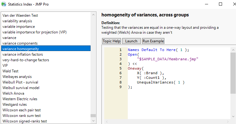

It is an option under the Fit Y by X(Oneway) analysis
You could have found this by searching th Statistics Index for it

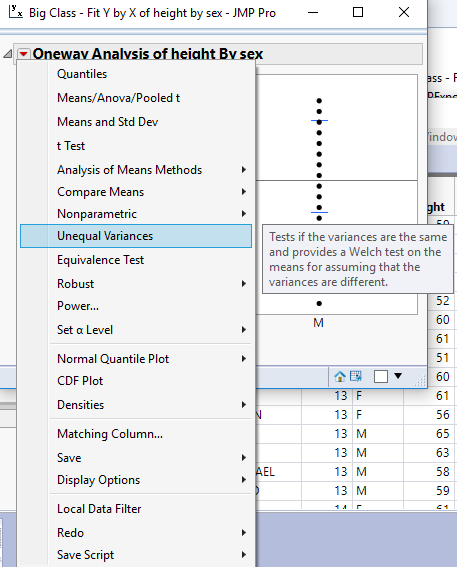

Adding to Jim's help, choose Pooled t if the variances are not different or t Test if they are different.
