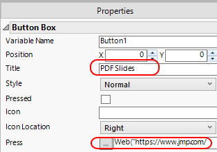

After switching back to the Application Builder mode, you can add buttons by dragging them into the workspace.  Keep in mind that in Dashboard Mode, the builder adds all required containers (Tab List, H Splitter, V Splitter) for simplified layout.  In Application mode, containers need to be added directly.  In this example, I added an H List Box that contains two Button Box objects:
Note that I placed the objects as close to the outer Tab Page title as I could.  I would not recommend placing supplementary material like this between reports in a Dashboard, because the report content (Tab Pages and Splitters) can be rearranged in the running dashboard.  Modifiying that layout can affect the run-time behavior of the dashboard.
Next, for each button you can add a title and action script from the property panel (open from red-triangle menu or by dragging splitter from the right edge).  In this example, I used these commands to open a web resource or local file:
Web("https://www.jmp.com/support/downloads/pdf/jmp_user_guide.pdf")
Open("$SAMPLE_SCRIPTS/bootstrapSample.jsl")
The attached jmpappsource file contains a finished result.

In the example App that I posted, the "PDF Slides" buttons works for me in HTML, because the JSL is a simple Web() command.  The "Script" button does not work, because the more general Open() command (and may other JSL commands) are not supported by the HTML report.
If your Web() links are not working, please see the discussion Interactive HTML hyperlink doesnt work .  It has a some additional suggestions on how to produce a simple Web() expression that the HTML report will recognize.  If you need a more complex script to come up with the URL to open, you might want to do that work in the Module script of the Application, and then do something like:
Button1 << Set Function(Function({this}, Web(...));
This way, the logic for computing the URL will run only when the dashboard runs rather than each time the button is clicked.  The JSL associated with the button will be a simple Web() command with a fixed string.
