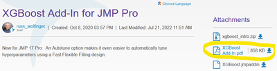

Because you have JMP Pro, and you mentioned Stratify, here is another option: "Make K-Fold Columns" from XGBoost Add-in for JMP Pro (https://community.jmp.com/t5/JMP-Add-Ins/XGBoost-Add-In-for-JMP-Pro/ta-p/319383) And read page 3, 4, 5
in the "XGBoost Add-in.pdf" file.
The function creates subsets (the Add-in calls it folds) that keeping original distribution (the Add-in calls it balanced), while respect stratification by keeping stratification variables balanced as well. See the histograms on page 5 in that pdf document.
