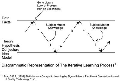

I use Scientific Method (i.e., an iterative process of induction-deduction, examples include Deming's PDSA or Box's Iterative Learning Process) as a basis for all investigations.
The impetus or motivation (e.g., reduce cost, improve performance, respond to customer complaint, add function, etc.) should be stated, but care should be taken as this may simply be a symptom . A decision should be made as to whether this is a study to explain what is already occurring or is the study intended to understand causal structure (I am biased to understanding causality). In addition, it must be understood what the constraints are (e.g., resources, sense of urgency). Start with situation diagnostics (e.g., asking questions, observation, data mining (this may include different regression type procedures), collaboration, potential solutions, measurement systems, etc.).  What are the appropriate responses?  Is there interest in understanding central tendency, variation or both.  Do the response variables appropriately quantify the phenomena?  I have seen countless times where the problem was variation, but the response was a mean.  That will never work.
Develop hypotheses.  Once you have a set of hypotheses, get data to provide insight to those hypotheses.  The appropriate data collection strategy is situation dependent.  If there are many hypotheses or factors (e.g., >15), the most efficient approach may be to use directed sampling (e.g., components of variation, MSE) studies.  The data should help direct which components have the most leverage.  As the list of "suspects" becomes smaller, perhaps experimentation can accelerate the learning.  This will likely follow a sequence of iterations, but the actual "best" sequence is likely unknown to start.  Error on the side of starting with a large design space (e.g., lots of factors and bold levels). This will likely be some sort of fractional experiment over that design space.  Realize, the higher order effects (e.g., interactions and non-linear) are still present, they just may be confounded.  Let the data, and your interpretation of what the insight the data is providing you, be the guide.
