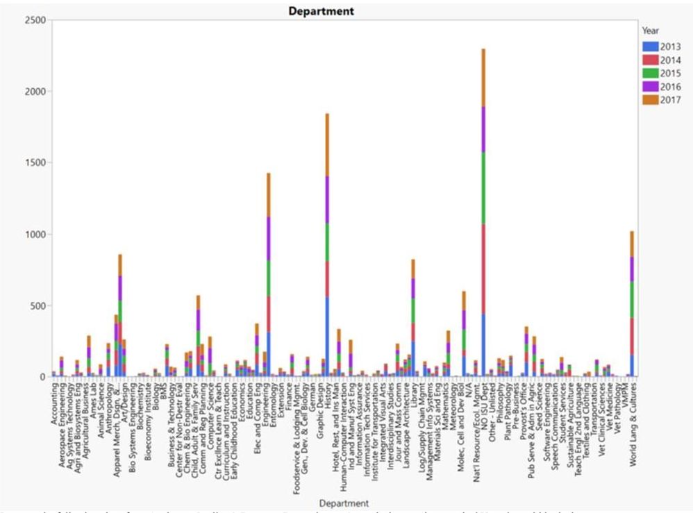

I have data on requests made by department over a 5-year period. I would like to build a chart that shows the number of requests by department, with each departmental bar stacked with yearly data.
I can make the following chart in Graph Builder, but can’t get the x-axis to reorder Ascending->Descending by bar height:

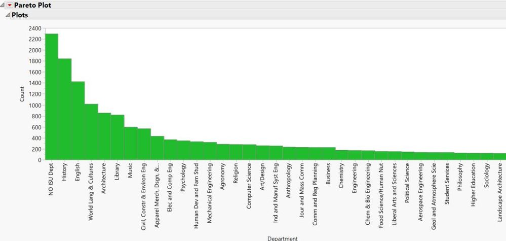

I can get this chart from Analyze->Quality & Process->Pareto, but can’t get the bars to show stacked Year data within the bars.
