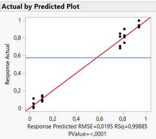

In your case, 81% of the variance can be imputed to your random effect, your day variable. Having a significant Wald p-value means that the response variance depends on the random effect, so your day variable (the whole plot). But that doesn't mean that your data is "rubbish". You can also first visualize your data and/or your model through different platforms, for example looking at the "Actual by Predicted Plot" available in different modeling platforms might already tell you if you can get a sensible model for your data or not (example from my sample datatable to reproduce the same conditions you have):
As an example, I added non-constant noise (increasing with the number of the row), and I have a very similar display like you for REML :
But looking at the fixed effect estimates (and after removing non-significant effects), I was able to detect 2 significant main effects, 1 significant interaction and 1 significant quadratic effect :
Depending on how large is your noise/variance (compared to the difference between levels' means you want to detect for the different factors/effects), your predictive performance might not be high. But it's worth to look at the Profiler, to have a feeling about how each factors may affect the response.
