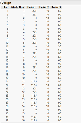

One possible option is to consider the two factors 1 and 2 as "Hard to change", and factor 3 as "Easy to change" :
Then, create your model with main effects, interactions and quadratic power for factor 1. Specify the number of Whole plot to 16 and the number of runs to 32 :
You'll have 2 runs per whole plot (for a total of 2 batches/4runs per day, so 2 whole plot per day) in which only the factor 3 will vary :
You can find the datatable for the design attached to evaluate the design and see if it fits your needs.

The number of whole plots is the number of groups of runs within which the hard-to-change factors remain constant. Hence, Victor set this to 16 because you can execute 2 combinations of your hard-to-change factors each day, over 8 days, 32 runs total.

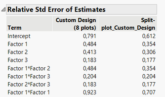

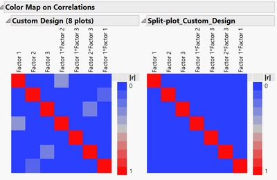

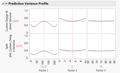

But if doing this design, that means the runs in each plot will be similar for the "hard-to-change" factors, so there will be 4 identical batches per day, at 2 conditions for the factor 3. This situation may not impact the power (comparatively to the design I have proposed earlier) for factor 3 since there is a randomization possible for factor 3 in each block (easy to change factor), but due to the "hard to change factors" which imply a severe restriction on randomization for these factors, it will affect the power of the "hard-to-change" factors 1 and 2, as well as the prediction variance for these 2 factors, precision of these parameters estimates, and aliases in the design :
Comparison of power between designs with 8 plots and 16 plots:
Comparison of prediction variance between designs with 8 plots and 16 plots:
Comparison of relative standard error of estimates between designs with 8 plots and 16 plots:
Comparison of correlations between terms in the model for both designs :

Makes sense, @Victor_G . Sorry, I had misread the 28 runs as 26. In any case, your 16 whole plot design will clearly be "better" than 7 or 8 whole plots. The relative difference in power is a useful indicator here: more changes to the factors => more power. But, again, I would stress that the absolute value of power is meaningless unless you have meaningful numbers for the size of the noise and the signal you need to detect.
