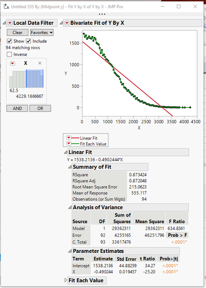

The easiest way to do this, is to use the Fit Y by X platform, and have it draw your curve and then to select
  1. Fit Each Value
  2. Fit Line
  3. Select Local Data Filter and select the X value to be filtered
Here are the results with my example data
Note that under the Parameter Estimates you can see the slope of .0038645
Now all you have to do, is to use the Data Filter to select only the values on the left side of the graph.fit2.PNG
The regression now is only calculated on the down slope, which is -0.490244

txnelson
Re: Slopes
You should be able to accomplish this, by excluding the data points on the left side of the curve, and then regressing the values from the peak value to the lowest value on the right.
For the poly curve line, you could use this technique multiple times.
Jim

Re: Slopes
  1. Fit Each Value
  2. Fit Line
Jim

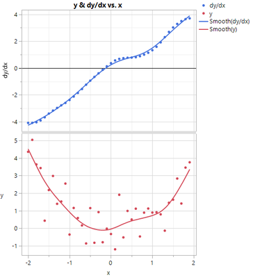

If you know the function of the curves or just do bivariate fit -spline fit and then save the prediction formula. Then do the derivative of the curve function under formula editor, screen shot below. you will have slopes at any Xs.

Re: Slopes
you can make a plot of dy/dx vs x. you can find where dy/dx=0, that's where y starts from decrease to increase in my example below.
