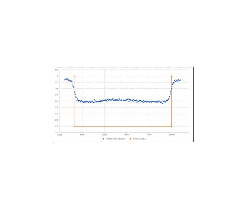

Is there a way to write a script to that graphs 2 different types of plots in one graph?
Hi, I am fairly new to jmp and am trying to write a script to automate something I have been able to do in other software. I am not sure what I am wanting to do is possible. I am trying to use some data to overlay 2 graphs, one is a scatter plot and the other is a line graph. I am able to do the scatter plot, but cannot figure out how to include the line graph one as well.
I have included some images of the 2 graphs I want to overlay, and also an example with other software of how it should look. I also will include what I have so far for my script.
Thanks in advance for any assistance.

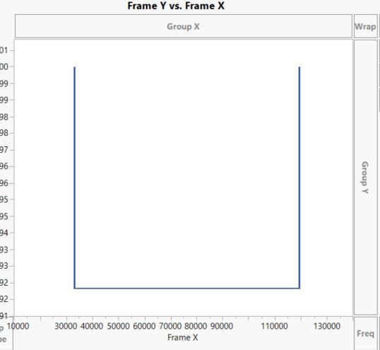

                    New Column ( "Frame X", Numeric, Continuous, Width( 10 ), Precision ( 7 ), set values( values1 ));
                    New Column ( "Frame X 2", Numeric, Continuous, Width( 10 ), Precision ( 7 ), Formula(76200 - (Frame X/2)));
                    New Column ( "Frame Y", Numeric, Continuous, Width( 10 ), Precision ( 7 ), set values( values2 ));

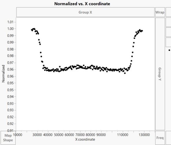

                    Graph Builder(
						Variables( X( :X coordinate ), Y( :Normalized ) ),
						Elements( Points( X, Y, Legend( 9 ) ) ),
						//Variables( X( :Frame X ), Y( :Frame Y ) ),
						Elements( Line( X, Y, Legend( 5 ), Row order( 1 ) ) ),

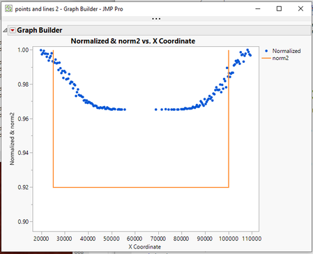

txnelson
Re: Is there a way to write a script to that graphs 2 different types of plots in one graph?
Here are 2 solutions.
First solution creates the graph with just the X Coordinate and the Normalized data, and then using Add Graphics Script, adds in the line
The second solution, adds in extra rows to the data table, and 1 extra column, and then by specifying which variables to show points for, and which one to show a line for, the Graph Builder comes up with the final plot
The 2 data tables are attached and the scripts for each version are saved to the respective data tables.
Jim

txnelson
Jim
GardDog
Level III
This is perfect, thanks so much. I appreciate it so much. I have been trying to figure out how to do this for quite a while.....I was able to get it to work on my dataset....now I just need to see about adding the values for the line graph into the columns. Using your column names, the X coordinates for the line will be dependent on a user input value, so they will change, but the norm2 will always be the same 4 values. I see you replied to the other post I made about this. I will review that one. Thanks again.

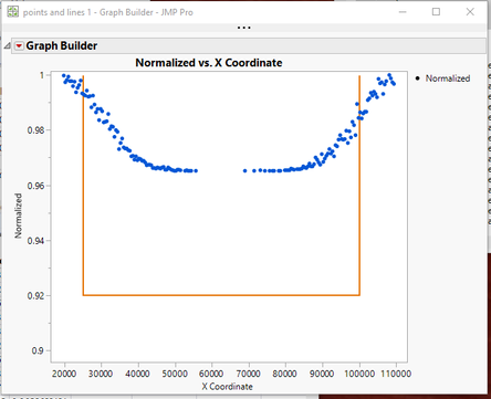

txnelson
@GardDog
I am responding back, to urge you to reevaluate the first option that I showed you.  It has the distinct advantage of not messing with your data.  Below is a rework of the script that Graph Builder produced for the first option.  The reworked code will show you how to incorporate calculated values directly into the graphical output.
Names Default To Here( 1 );
dt = Current Data Table();
// Determine your X Matrix
// Here it is just being assigned, but you can easily create it in your code
xMat = [25000, 25000, 100000, 100000];
// The yMat is static, so it would be input as is
yMat = [1, 0.92, 0.92, 1];
gb = dt << Graph Builder(
	Size( 534, 456 ),
	Show Control Panel( 0 ),
	Variables( X( :X Coordinate ), Y( :Normalized ) ),
	Elements( Points( X, Y, Legend( 5 ) ) )
Report( gb )[FrameBox( 1 )] << Add Graphics Script(
	Pen Color( "orange" );
	Pen Size( 2 );
	Line( xmat, ymat );
report(gb)[AxisBox(2)] << min(.91);
Jim
GardDog
Level III
@txnelson
This is great, I really like this solution. Thanks for sending this one.
