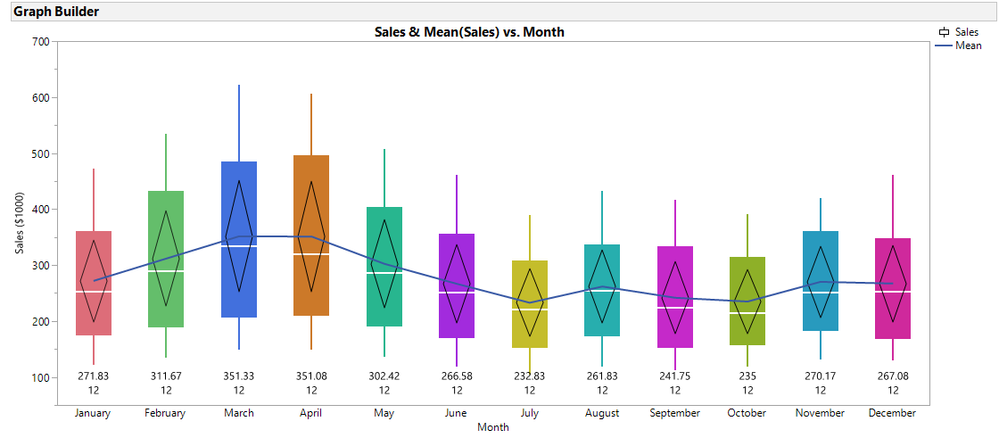

Right click on the graph builder frame box and select Customize. Then select a box and there is a check box for Confidence Interval.
Via the UI you have to edit each box. Below is a picture with several options that you can select.
However, it is much easier to do this via a script. The script to create the picture below is attached.

Re: Show means on box plot in graph builder
The attached script has been updated. Note this script shows hardcoded column names and rounding units, it does not  include data prep etc. Both the mean and n has been added

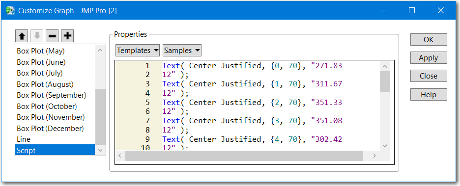

Right click on the Graph Builder Frame Box. Select Customize.  Select the  plus sign (+)  above the list of boxplots.
Select the  Templates menu above the Script Box, and select Text, then fill in the information. Select Text again and add the information for the next box.  Note there is an option available in JMP 14 Graph Builder boxplots to show the 5 number summay for the box, but that does not include the mean.

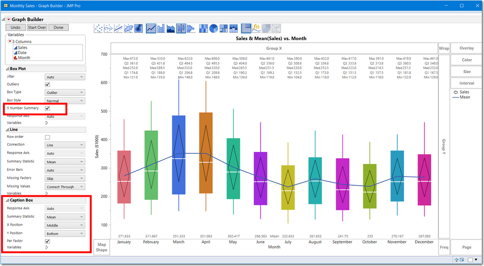

I am learning on the fly. JMP 14 already has a feature that fulfilled my wish list: the CaptionBox has a factor checkbox so it work for each category displayed on the X-Axis.
This displays the 5 number summary (min, Q1, Median, Q3, max) and the means as a caption box.
image.pngHere is the script showing the customization, for just the first boxplot.

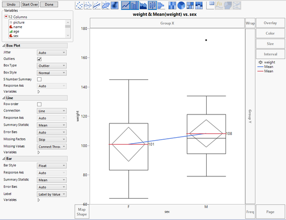

I think the easiest way to get the mean labeled on the boxplot graph is to add another element. Use the Shift-click on the bar chart icon. Make sure that the summary statistic for the bar chart is the Mean. Change the bar style to "Float". You then have the option to "Label by Value". All interactive and provides the label. Enclosed is an example using Big Class Families (with the control panel still on so you can see those options).Boxplot with Labeled Mean.PNG

Thanks Dan. That is great way to show the mean right at the box plot.
