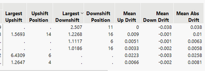

I know that Process Screening platform has Shift Detection but I'm not sure if that is what you are looking for Process Screening Platform Options (jmp.com)
MSA platform also seems to have Shift Detection Profiler (jmp.com)
and then there is Example of Operating Characteristic Curves (jmp.com).
I found these by searching from JMP Help https://www.jmp.com/support/help/en/17.2 and from scripting index using Shift as search term. There is also Search JMP which can be used to search for things in JMP (Help / Search JMP)
