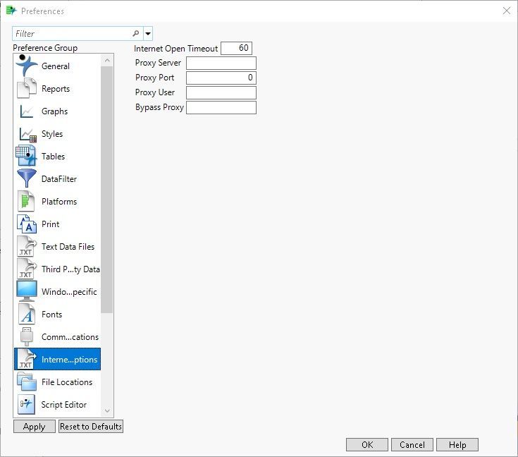

Re: Set a web proxy for New Http Request
It's in the Internet Options
Hi @bryan_boone, do you know how to use this new option added to JMP 15?  I can't seem to find it in the documentation.
Aah, I was looking for a way to do this per call.  Thank you.
Proxy Settings.jpgYou can do that, too
It's in the Scripting Index.
However most networks are "auto configured" these days. I there some other context?
