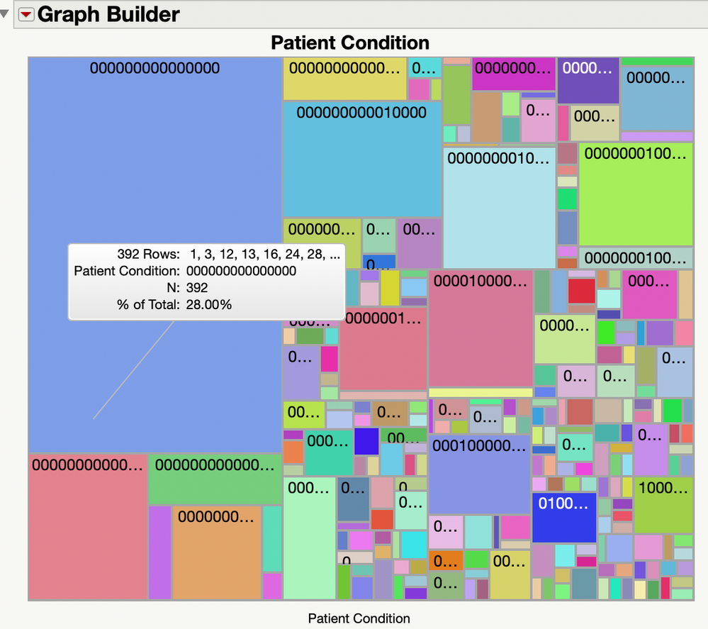

Re: how to compare rows with 0 and 1 to find out the prevalence and clustering of two medical conditions?
It occurs that "the order for the most common combinations for two medical conditions in the same person" could imply a few different analysis objectives. But, whatever analysis is implied, I would strongly advocate taking a look at what's 'in' your data first.
One approach would be to use "Cols > Utilities > Combine Columns...' to make a new column containing the status of each patient for every condition. Then you can use 'Graph > Graph Builder' to make a Treemap of this new column, and inspect the results via the tooltip. If you are not sure of the details of how to do this, try the online documentation. Be aware that, with so many conditions, this may just be a mess.
As a new user, you probably are not interested in scripting. But the script below simulates some data, and makes the Treemap. Because of the randomness, what you see may be different each time. But running this code should produce a graph like:
 To run the script do 'File > New >New Script', paste the code into the window that appears, then do 'Edit > Run Script'.
