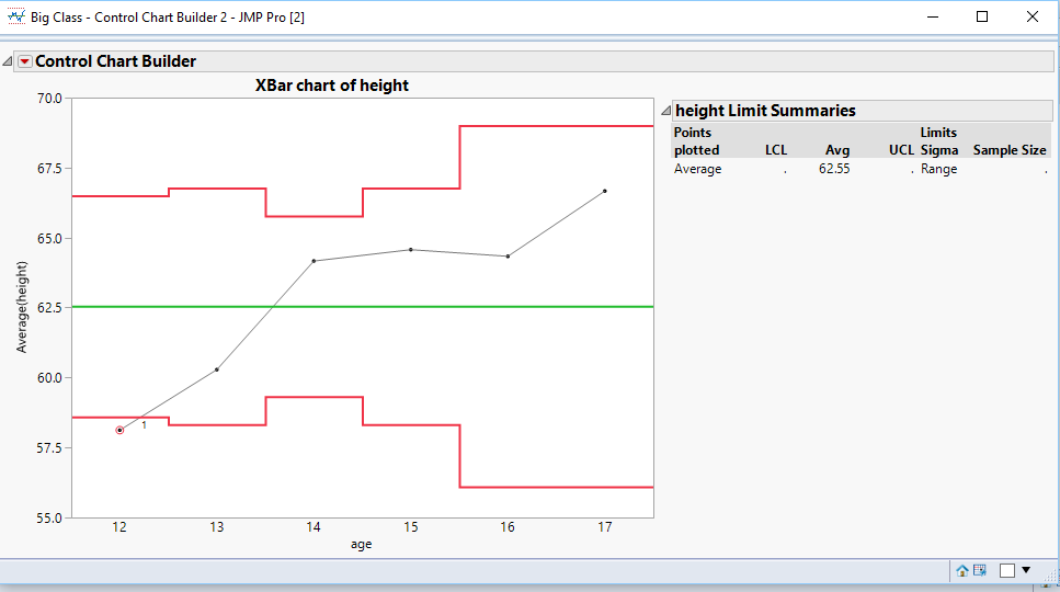

Here is a script using the Big Class data table, and your script, running in JMP 12.2 and it seems to work great
Control Chart Builder(
	Show Two Shewhart Charts( 0 ),
	Size( 650, 500 ),
	Show Control Panel( 0 ),
	Show Capability( 0 ),
	Variables( Subgroup( :age ), Y( :height ) ),
	Customize Tests( Test 2( 8, "2" ), Test 3( 7, "3" ) ),
	Chart(
		Position( 1 ),
		Points( Statistic( "Individual" ) ),
		Limits( Sigma( "Moving Range" ) ),
		Warnings( Test 1( 1 ), Test 2( 1 ), Test 3( 1 ) )

Re: [Script] Get rid of Moving Range chart in control chart builder
Thanks, but it doen't work for me.  Must be something specific about 12.1.0 (not Pro).  Good to know at least this will be fixed in a later version, though I hope it will be fixed in the non-pro version.
