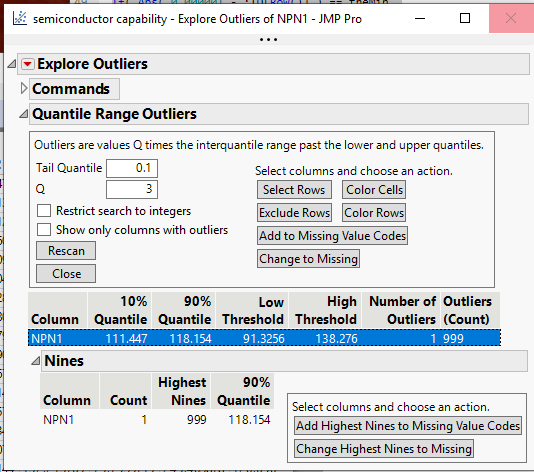

I have some data that has outliers.  I was able to find them using Explore Outliers.  I selected only 1 column of data and another categorical one to group by.   I used the Quantile Range Outliers command, and one outlier was detected.  I'd like to color or select that cell.  When I choose one of the options, I get a JMP Alert: "Select a column or columns before clicking this button".  How do I select a column?  I tried clicking one in the data table, but that didn't work.  I don't see any other way to select one.

You need to select one of columns listed below the selection box.

At the bottom of the report, you should see a result table with the name of the column you used as input, click on the column name, and then choose "Select" or "Color" cell.
