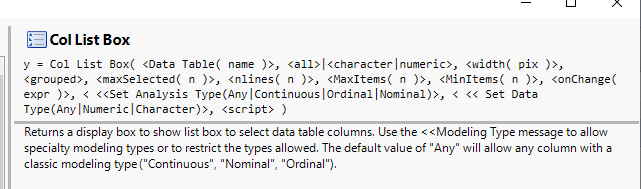

Here are the options available to Col List Box, taken from the Scripting Inded
     Help==>Scripting index
It has options for  setting the data type and the modeling type
Jim

Re: How to make Col List Box Report only specific data type
try that but it still show all columns.

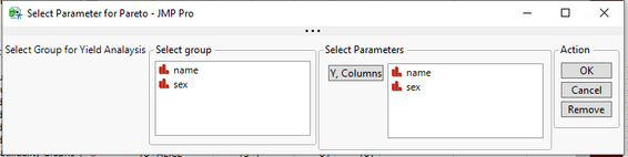

txnelson
Here is a rework of your code.  You had already limited the first Col List Box() to "Character", you just didn't use the correct syntax for the second Col List Box()
names default to here(1);
dt=open("$SAMPLE_DATA\big class.jmp");
nw = new window("Select Parameter for Pareto",
borderbox(left(3),top (2),
		hlist box(
			textBox("Select Group for Yield Analaysis"),
			hlistbox(
				vlistbox(
						panelbox("Select group",
						ColListData = collistbox( all, << set Data Type( "character" ));
			panelbox("Select Parameters",
				LineupBox(NCol(2),Spacing(3),
                        ButtonBox("Y, Columns", colListY<<Append(colListData<<GetSelected)),
                        colListY = ColListBox(all,nLines(5), << set Data Type( "character" )),
			panelbox("Action",
				button box("OK",
					list = eval(colListY<<getitems);
					nw << close window;
				button box("Cancel",nw<<close window),
				button box ("Remove",
					 colListY<<removeselected;
Jim
