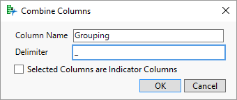

The very easy way is to select the columns that you want the new variable to be based upon(Gender, Income) and then go to the pulldown menu, Col==>Utility==>Combine Columns.
Fill in the new column name and the delimiter and you will get your new column
Jim
Re: Saving a filter definition as a new column
Thank you for your quick reply Jim.  that seemed to work for combining 2 variables (thanks for that, I didn't know I could do that).  But that doesn't allow me to apply logic that I need (an "and" or an "or" logic) between the 2 column/variables.  I don't want all the elements of each column, just specific criteria from both with some type of and/or logic, to in turn, save this as a new column/variable.
So combining the 2 columns gave me all the elements from both columns at the top of my table.  But it doesn't allow me to find the criteria of:  only females who are low income, then save the variable in my list, Then find the criteria of:  males who are only low income, then save that variable in my list.

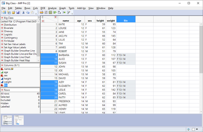

Try using the Data Filter to select the rows that meet your criteria and then use Rows > Row Selection > Name Selection in Column​ to create a new column with the name of the selected (and unselected rows).

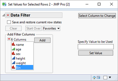

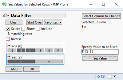

I liked the suggestion that Jeff made, about using a data filter to do the selections.  So, I put together a simple addin that lets the user use a Data Filter to do the selection, and then specify the Value to be written and the column it is to be written to.
One selects the column to change and then uses the data filter to select the rows to be changed.  Then one places the value to be used to identify this grouping, and then click on the Set Value button.
and the values are then set for the selected rows in the data table
I have attached the JMP addin
