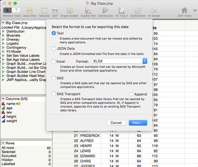

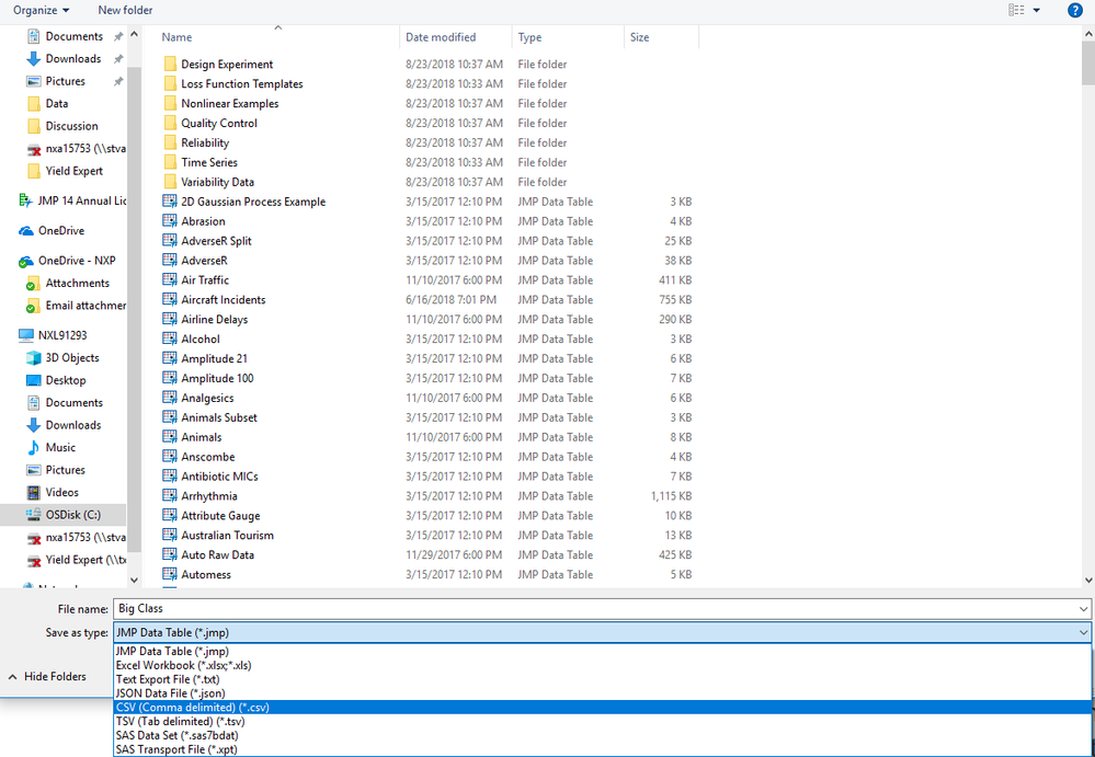

I am trying to save a subset of a table which is in sav format into a csv file. Under this link I got clear instructions. However, my JMP14 does not have the option to select a type list to save in.

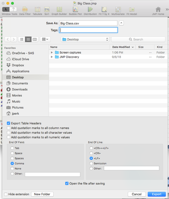

Choose Text and on the subsequent dialog set the End of Field delimiter to "Comma". Make sure that the "Hide Extension" checkbox in the lower right is off and you can change the extension from ".dat" to ".csv".
No I don't. I am using JMP14 on a Mac so I guess it is different from Windows, but still in other applications I have such a field where I can save as something.
