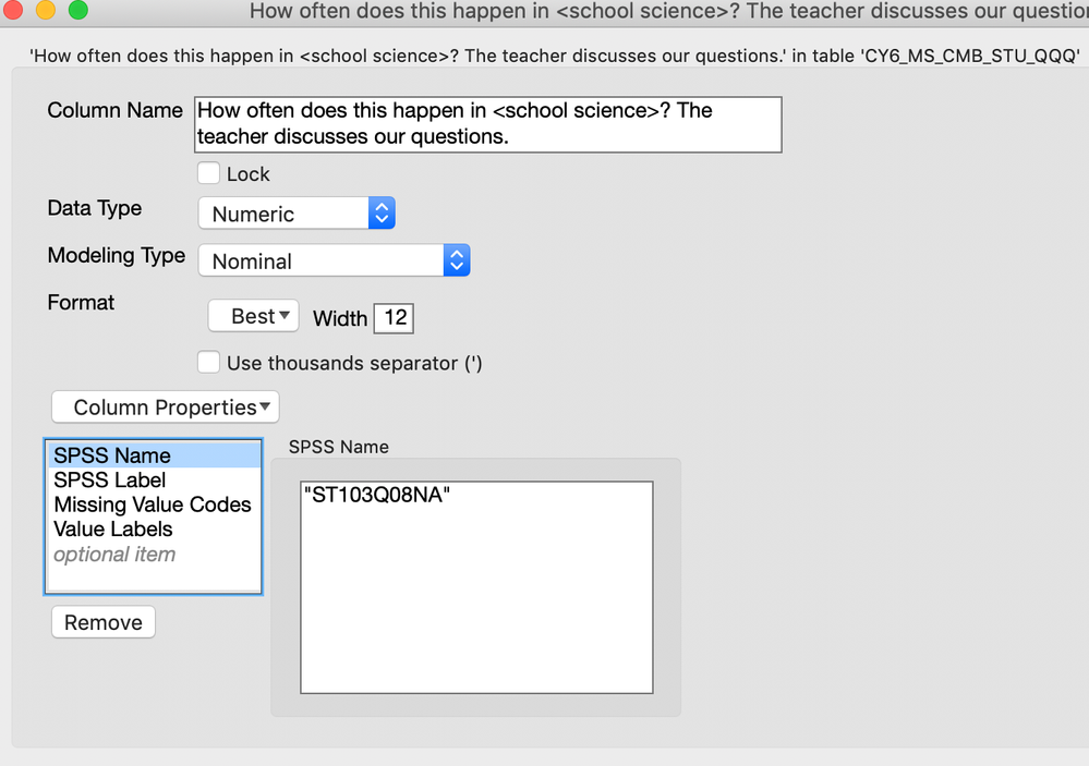

Hi there, I am trying to display all the SPSS names of the columns as I can select in the column info (see below).
Is that possible?
Other question: I want to access a specific cell given the specific columnnumber and rownumber. How can I do that?
Thank you.
(right-klick on column name>column info)

There is a JMP Preference in the Tables section of the Preferences called "Show Alternate Column Name".  When this Preference is selected, the column name will be made up of a concatenation of the SPSS Name and SPSS Label, when the data table is created.  But short of that, the only interactive method I am aware of is to go through each column, and copy the value of the SPSS Name, and paste it into the column name.
However, the following script, will quickly go through each column and change the column name to the value of the SPSS Name, if an SPSS Name exists

Yes, I want to change the column names to the SPSS names. How can I do that?
Is there an easy klicky-way, using the mouse only? My coding skills in JMP are non existent. (I am using JMP for data-transfer only.)
