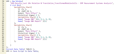

Hello together,
applying a simple JSL Gage R&R script, I would like to save this variability charts into the table by using the JSL "Save Script to Data Table". Unfortenately, this doesn't work:
This function works without problems on the graph builder, has someone an idea how it works succesfully on the variability charts?

Re: Save Script to Data Table JSL Script Doesn't Work on Variability Gage R&R Charts
Hi,
Please take a look at this post on how to save New Window scripts to data tables: save New Window scripts into data table
Thanks, this works, but I propose to simplify the Variability Chart Script itself so that the function "Save Script to Data Table" works on all the different graphs, charts, etc.
